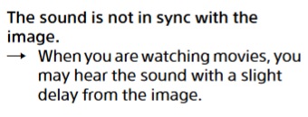

In the troubleshooting section of the HT-CT390 manual, it says:
Unfortunately it doesnt tell you how to resolve it - which indicates to me that there is no adjustment in the soundbars settings.
Saying that, have a look at the settings on your Bluray player, many do have an 'Auto Sync' or manual adjustment setting somewhere.
