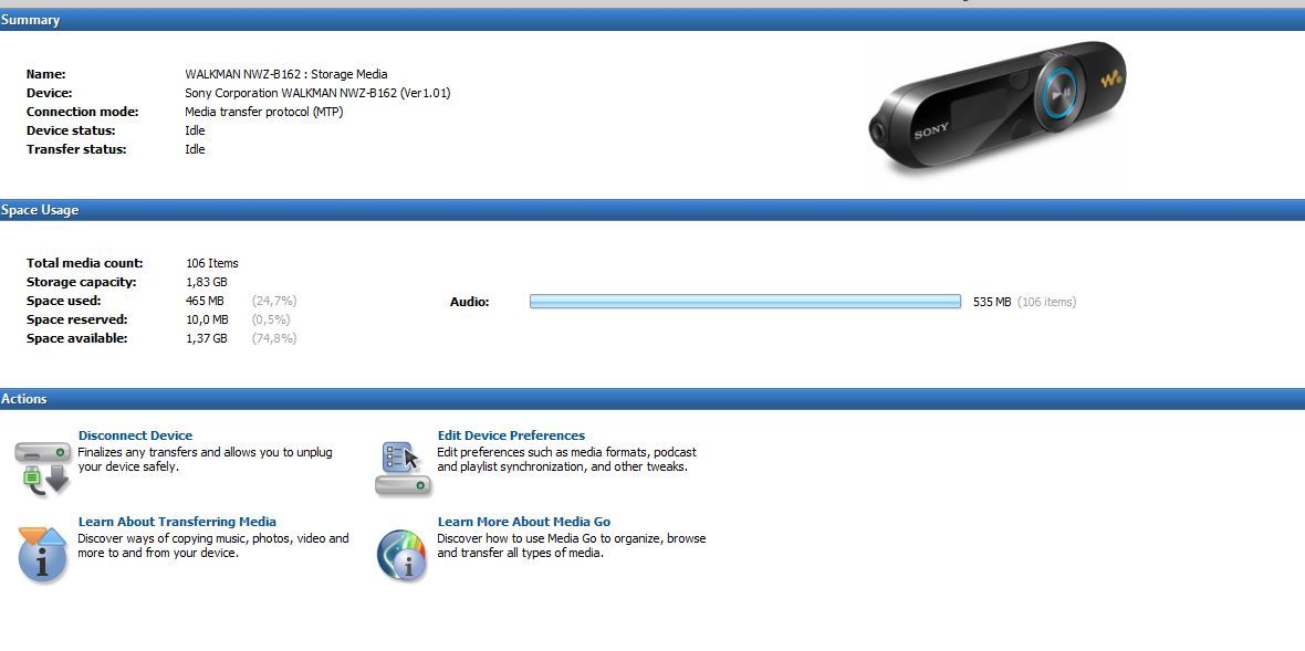

Hi, thank you. I installed Media Go and checked updates.Now it looks like this. The screen turned back to normal for 4-5 seconds earlier while i was trying to finish the battery. I finished it and plugged back but the screen is again blank, just lights are on.
Reset is not helping. I contacted Sony support. Maybe I can format the walkman using settings but I need another walkman to complete the steps successfully. I searched for videos or images for the menu but I couldn't find anything helps.
