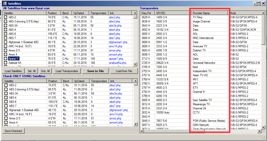

I now found out that @svansvan's SDBEditor is able to download transponder lists from flysat.com and write them to a Satellites.xml file. Can those be imported by Sony? How? The same way as channel lists are imported maybe?

Thanks! Hoped @svansvan could comment on why his SDBEditor is capable of generating the Satellites.xml. Must have some reason, no?

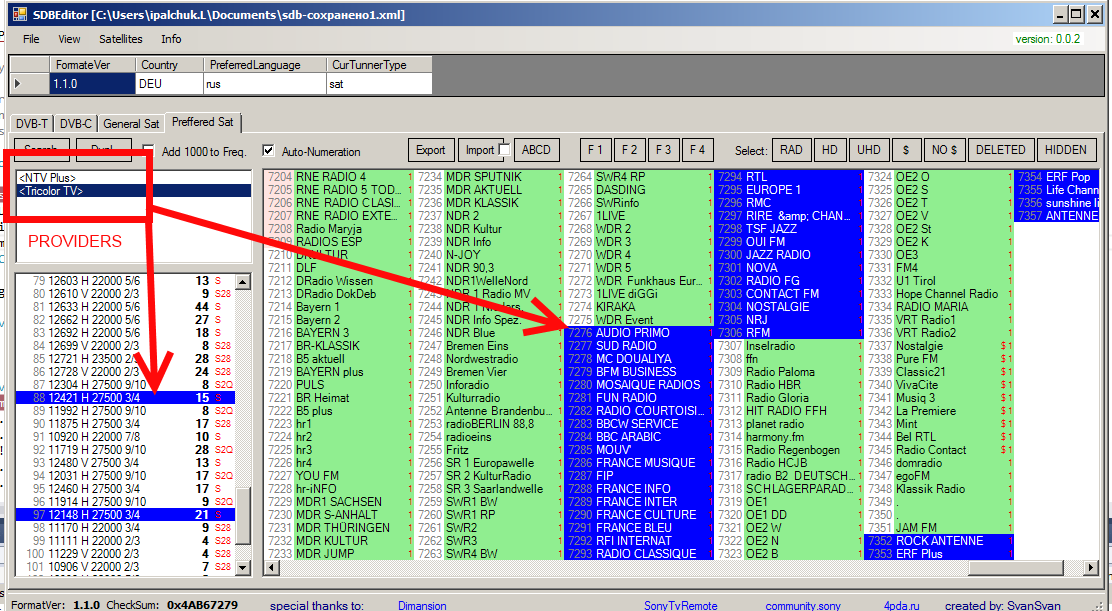

Sdb.xml Does not contain any data about the Provider Name.
People very often want to understand which provider this channel.
Or to delete the scanned, but unnecessary provider.
I am far from satellite TV. Sdb.xml For me it's just a database file.
I'm just a programmer, what they say, I'll do it. I was advised to use this site: www.flysat.com
This site does not provide its services. So it's just parsing html code.
Sometimes the site changes its markup (adds removes columns in the table) and has to redo the program logic.
No alternatives were found either on the sites or in the programs. And all this is just for display PROVIDER NAME 😞
I doubt that this site will make its service.
I doubt that SONY will do something like that. We have what we have.
As hardly anyone will be interested in the source code of the program, which I very long ago uploaded in on the site. With the source code, you can do whatever you want. No copyrights
Well, just technically: Sony has a bug that has not been fixed yet, where the transponder frequency is overestimated by 1000. This happens only on some TVs. In the program for this case, I also created a checkbox (+1000). (Then the provider names are displayed correctly).
But in general: of course, all this can be called one word - crutches
Thanks for your response.
So the Satellites window in SDBEditor serves no purpose but to show providers on the transponders? And what are people then supposed to do with this info? And why would you export it to a Satellites.xml? So as far as I understood, this feature serves no purpose at all then?
Thought it was probably somehow possible to import the Satellites.xml to the TV (like it is done with Enigma2 boxes) which it will then use for scanning, which is what actually would make sense... to update outdated transponder lists in the TV...
Knowing the transponder parameters in sdb.xml and having the same parameters but from the site - only so you can find out the name of the provider.
And I write this in a file, so that this operation can be done only once and work offline. And I download all the data from the site, only to the effect that it can be of interest to someone.

SDBEditor is very good BTW. Way better than SetEdit (Sony Editor). Sony should switch...
The only thing that took me some time to get used to was that moving channels works via right mouse button...
