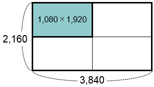

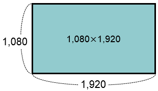

4K is a common name for a resolution with has about 4000 pixels horizontally. The resolution of an image or TV screen is the number of pixels that make up that image. The more pixels an image has, the sharper and more detailed it will be.
A 4K picture has a resolution of about 8,290,000 pixels, which is 4 times that of full high definition (2K). Even when viewed on a large screen, it achieves high definition picture quality down to the smallest details and reproduces realistic details and textures. 4K may also be called Ultra HD (UHD) because it has a higher picture quality than high definition (HD).
2K 4K
