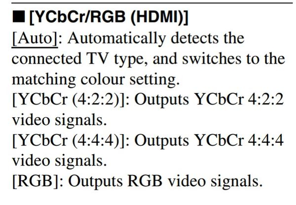

Hi there
You will need to consult your TV manual and have a look at the HDMI settings.  Many TVs allow you to customise the display settings (i.e. brightness) on each HDMI input, can this be done on your TV?
The only couple of setting that may help on your BDP-S4500 is:
