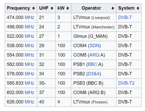

Channels 21, 24 and 27 are very low power local relays. You can see the difference in transmitted power here, between 1 and 3 kW vs 100kW for the main multiplexes.
Did you ever try the attenuators ? Given that the local channels are so far down in power I would have thought you could kill the signal for those with a simple attenuator while leaving the main ones still at a good level. Even if only as a test to see if what Sony say works.
You will find the Sony works fine even down to low signal levels and so attenuating to bring the main ones down to say 70% should totally remove the others. An 18db attenuator will drop the level (the signal voltage) by 87.5% and a 24db by 94%
Attenuators can be stacked and the values simply add. So a 15db and 6db give 21db overall. I can't really think of anything else easy to try.
(Those are massively high attenuation levels but even my loft aerial will stand 18db attenuation)
