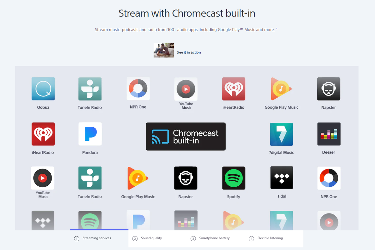

The STR-DN1080 AV receiver Chromecast capability is slowly disappearing with many apps now unable to stream to it due to the fact Sony has NOT incorporated the latest Chromecast Built-in software update (currently at 1.47.xxxx) making it incompatible with current apps. Sony is currently providing 1.21.xxx version Chromecast Built-in software which is very much out of date into their most recent firmware update. The issue has been confirmed by both Google and TIDAL technical support.
The resolution to the problem is for Sony to incorporate the latest Chromecast Built-in software which is provided to them by Google into a firmware update which isn't a lot of work. This would go a long way to solving a lot of ***** off Sony customers who are livid with Sony's poor customer support and response to complaints about this very problem.
Pick up your game Sony, it's not like it's going to cost you money to solve this issue on products your sold unsuspecting customers - Google has already done the hard work on the software side, just provide it! 😞
https://support.google.com/chromecast/thread/39531774?hl=en
This is a lie and many of us were duped by Sony - Please update the Chromecast version provided by Google to restore functionality!
