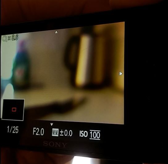

  • Manual focusing causes the image on the display to freeze for a couple of seconds, orange square appears at the bottom of the screen.
    When turning the focus, the picture freezes and moves a bit back and forth, then goes back to normal. The focusing works but it I'm interrupted by this behaviour. During the freezing, there is a small black screen in the bottom left with a orange square:
    During manual focusing, freezes 2-3 secoondsDuring manual focusing, freezes 2-3 secoonds
