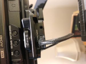

Hi, a question regarding my Sony FDR-AX700 connection to Manfrotto MVG460 Gimbal. I am trying to connect my camera to the above Gimbal using the proper connection cable USB from the Gimbal as seen in Picture belowIMG_0857.JPG
I then connect the lead to my FDR-AX700 as seen in the picture below.
When I turn on the Camera and Gimbal I get the following message on the screen, I cannot make any connection to operate my Camera stop/start from my Gimbal. Any help would be helpful.

mmmmm 🤔
seem that your camera is configured as “mass storage”, try to choose a different selection here
https://helpguide.sony.net/cam/1710/v1/en/contents/TP0001492480.html

On Manfrotto site is not clear if AX700 is supported.
You have to cross fingers 🤞

Thanks danardeng will certainly give that a go.

Sadly it did not work.
Regards Chris

I feel the Camera may not be compatible to the Manfrotto Gimbal.

But are you able to stabilize the camera without cable connection?

Yes, the Camcorder I found was easy to Balance etc
