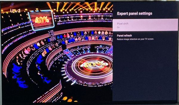

You may also have Expert Panel settings under Settings> Display & Sound, here you can set Pixel Shift to ON, and also run Pixel Refresh, Sony recommend only doing this once a year.
The TV may run its own calibration after being turned off for a couple of hours, my TV does this.
After the TV has been put into Stand By it will recalibrate the pixels after a few hours, it does this in the background without having to switch the panel back on, this should keep burn in at bay.

The TV will carry out its own calibration a couple of hours after going into standby, this should keep on top of any image retention, pixel refresh is there (only to be used sparingly), or the manual calibration I described, the Bravia 8 II may have different controls or other methods, find out over on the Bravia 8 II pages at AVForums.
