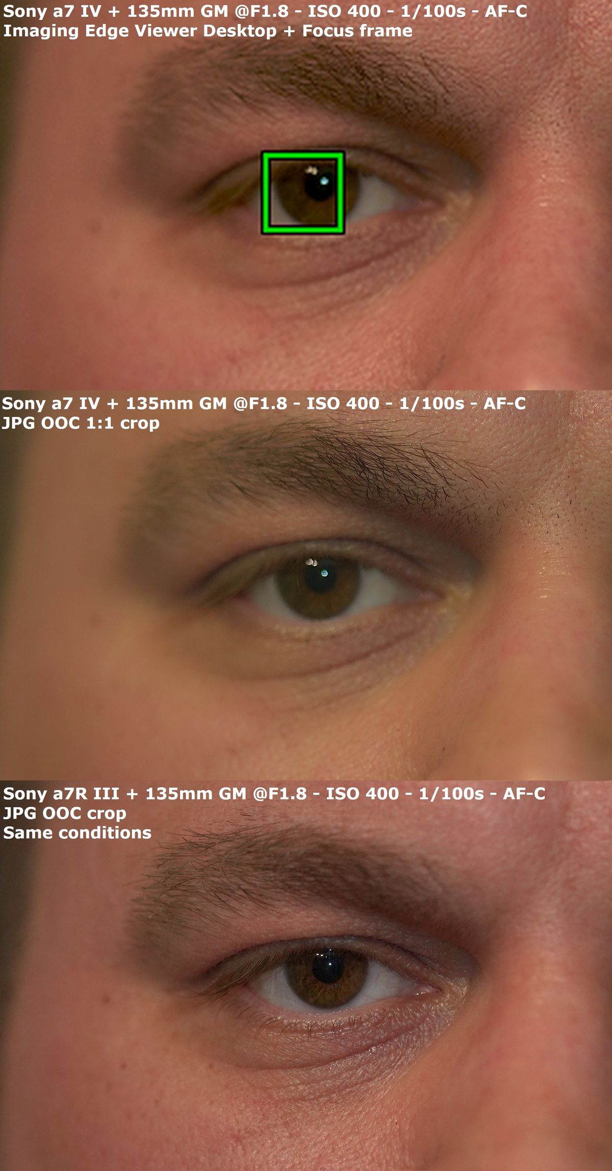

I can reproduce the front focus Eye-AF issue easily with human, if I'm shooting head/face portraits that are filling the whole frame in combination with my Sony 135mm 1.8 GM @F1.8. Others reproduced it with 35mm GM and some more Sony lenses as well.
I did test series and compared directly with my a7R III under the exact same conditions with the same settings and the same light.
a7 IV hit the eye brows only (not even the eye lashes, the whole area was completely blurred out) in 75%-90% of the shots. Really sharp are only 1-2%. There is some variation when repeating the tests. If you are lucky you'll get 50% "better" shots. But it's unusual for head portraits.
The a7R III made focused the pupil razor sharp at least at 80% of the shots and very good at another 15% of the shots, which is an overall of 95% good shots.

This is how the problem will look like by 75-90% with face portraits, if you are affected (135mm 1.8 GM @1.8 from 100cm distance in that case):
I hope this is helpful to other affected users.

schildzilla
Member
Just to show you the freshest samples and how much better the a7R III nails the eyes every time.
The a7 IV always nails the eye brows every time. This a7 IV is weird. The ad said "Basic never has been this good". (https://electronics.sony.com/imaging/interchangeable-lens-cameras/all-interchangeable-lens-cameras/p...)
But the a7R III with it's weak AF system has been very much better here. So basic has been not only this good (if you will call this good), it has been better.
a7 IV vs a7R III + Sony 135mm 1.8 GM @F1.8 - ISO 400 - 1/100s - Eye-AF precision (head portrait)a7 IV vs a7R III + Sony 135mm 1.8 GM @F1.8 - ISO 400 - 1/100s - Eye-AF precision (head portrait)
